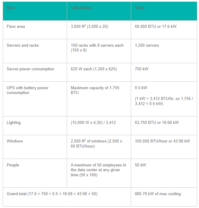

1. An Overall Data Center Cooling Load Calculation
Consider the following scenario for a typical data center:
Because most HVAC systems are sized in tons, we can use the standard conversion equations (watts x 3.41 = BTU/hour) and (BTU/hour / 12,000 = tons of cooling):
  • 76 kW = 880,760 W x 3.41 = 3,003,391.6 BTU/hour
  • 3,003,391.6 BTU/hour / 12,000 = 250.28 t of max cooling needed
This diagram shows how components, systems, people, and other factors interact.
Even at maximum utilization, the UPS system in this data center produces so little heat that it accounts for less than 1% of the total heat production. The majority of it is generated by the rest of the IT equipment.
