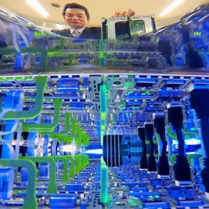

Liquid Immersion Cooling
Photo credit: www.fujitsu.com
This method is one of the revolutionary methods of data center cooling. It is the use of dielectric coolant fluid to gather the heat of the server components. Dielectric fluid can be used directly to electrical components such as CPUs, drives, memory, etc.
Liquid coolant is a hundred times more efficient to run through a server’s hot components and take the heat away to a heat exchanger than massive Computer Room Air Conditioning.
Compared to others, only this data center cooling method can make unprecedented PUEs possible.

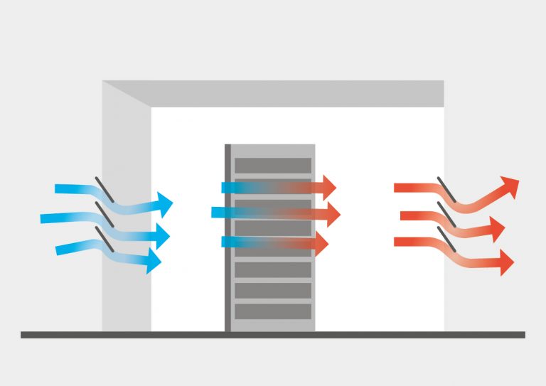

Direct Free Cooling
Photo Credit: www.stulz.de
To put it briefly, this could be described as follows: window open, blow cold air from outside through the Data Center, pick up the warm air, transport it back outside. Only the process of “moving the air” requires energy.
This is simply where the data center allows the air outside to enter the facility. However, it is not as simple as letting the air in your house. Outdoor air is not always clean and acceptable for a facility, like a data center. Outdoor air is often full of pollutants and contaminants that might be harmful to equipment. There might be times that the air could be too hot or too cold, or sometimes too humid or dry.
So by using the direct free cooling method, the data center must be prepared to have equipment or means to control the air in financially acceptable measures.

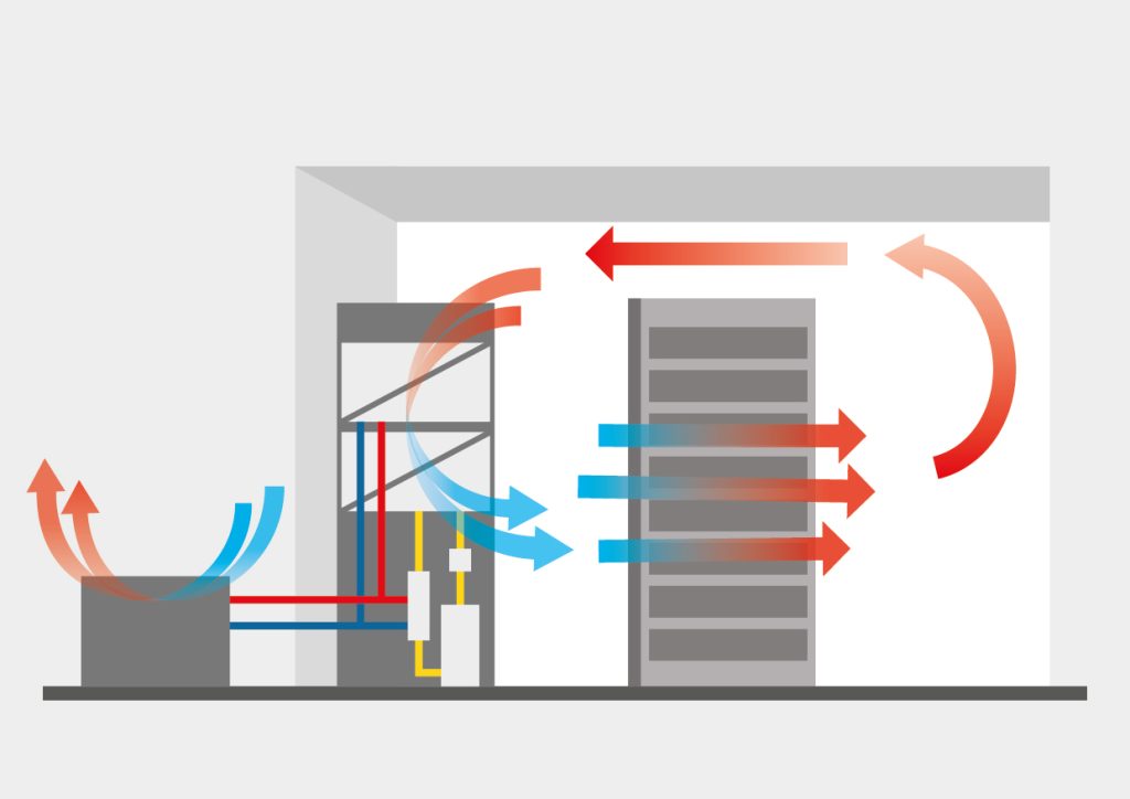

Indirect Free Cooling
This free cooling method keeps the windows shut. Outside air can not cause havoc inside the data center. This cooling may not be as complex as direct free cooling, however, this one is less efficient. In this data center cooling method, there is always at least one heat transfer.
Unfortunately, however, Indirect Free Cooling is less efficient than Direct Free Cooling. As there must be at least one heat transfer to take place between the air in the Data Center and the outside air. At least one heat exchanger is required, and that means a loss of efficiency.
