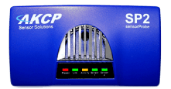

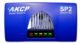

sensorProbe (SP) products
SP2
Security status: ATTENTION
Latest firmware: 476
No shell access is provided.
Important: the sensorProbe family doesn’t provide support for any secure protocols such as SSL or HTTPS. Therefore, it doesn’t support secure email or web access, and only SNMP v1/2 is supported. This might make the product un-secure in some environments unless it’s running in an isolated network.
Nessus Security scan results:
Web Application Potentially Vulnerable to Clickjacking (low risk)
The built-in web server does not set X-Frame-Options or Content-Security-Policy (with the ‘frame-ancestors’ directive) for the HTTP header. This would prevent the page’s content from being rendered by another site when using the frame or iframe HTML tags.
However, the sensorProbe WebUI does not utilize frames.
The sensorProbe family doesn’t provide support for any secure protocols such as SSL or HTTPS. This might make the product unsecure in some environments, unless it’s running in an isolated network.
